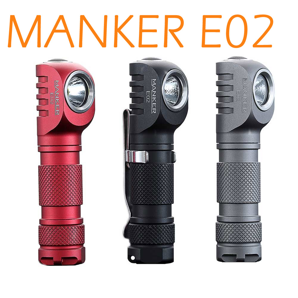

(停產) Manker E02 磁吸L型手電筒 220流明 日亞顯色/XP-G3冷白光

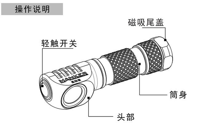

尾部磁吸功能

"L" shape design that together with a reversible clip and a sufficiently powerful magnet in the tail, offers us an almost infinite possibilities of use: it is comfortable in the hand, on a table, hooked in trouser pocket, shirt, a cinch Of a backpack, side of the car, refrigerator, any small field house, tent, ....

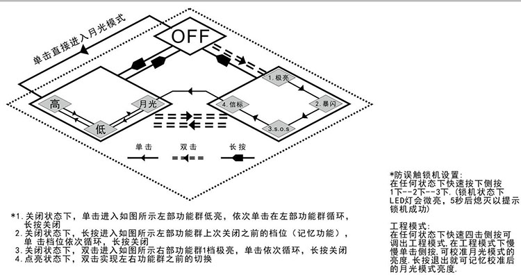

Brightness levels & runtime:
Moonlight 0.6lumens 84hrs
Low 16lumens 10hrs
High 70lumens 2hrs
Turbo 220-70lumens 3min-1.8hrs
Strobe 220lumens
